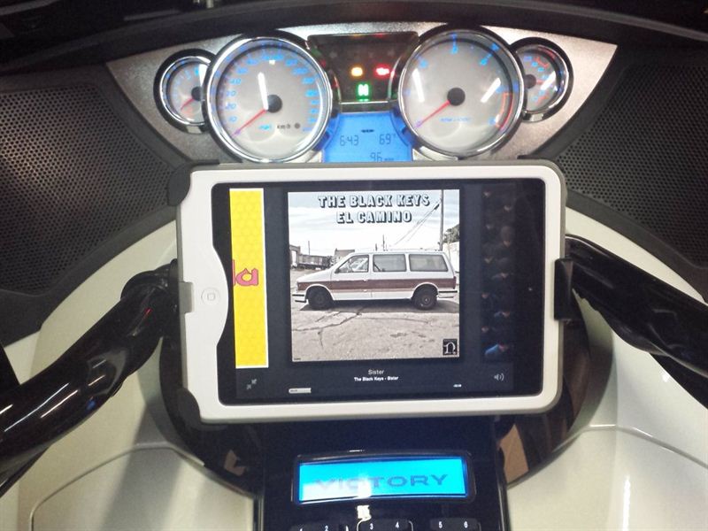

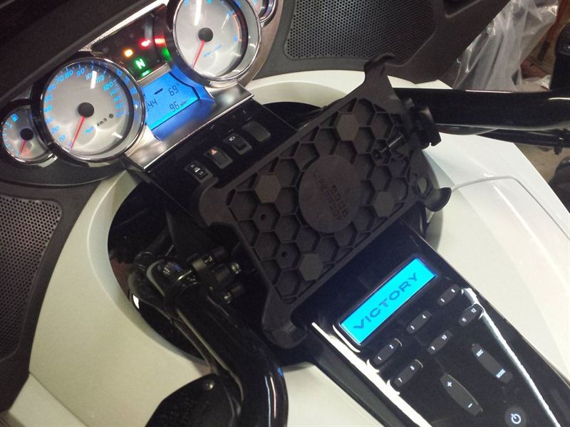

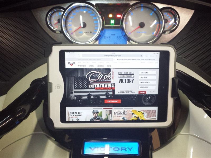

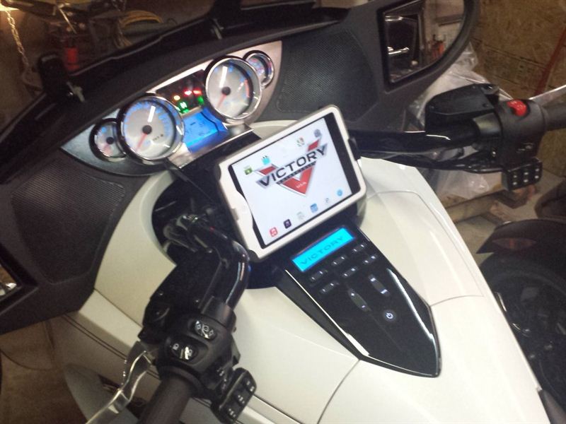

Posts: 60 Bradenton, FL | Well I knew it wouldnt take long, picked up my baby last Saturday (14 Vision) and have been madly planning my mod assault! Round 1 - tunes! Got to have a nice souce unit, so I decided to mount an Ipad Mini between the bars (future mod will be fully custom fiberglass pod in the stock radio location) Install was pretty easy, simply required a RAM mount, LifeProof waterproof case, LifeProof case mount and a bluetooth receiver. Here are some pics!
So now I have Siri, Pandora, Voice activated navigation, internet, hell even Netflix if I kick back at a rest stop to catch a flick... lol. Waterproof case will keep it from fryng if I get caught in a rainstorm and since its removable I can quickly stow it in a saddle bag for security. Next step, lets get some of this music sounding good! Am stripping the plastics off this weekend for an amp install and speaker/subwoofer installation. Will post more then. Damn I love this bike!  |
Posts: 3773 Pittsburgh, PA | i didnt know ipads were designed to be in weather.. I do respect innovation.. but this is so over the top big "out of scale". in some states there might be a risk of being pulled over.. Hell if a girl can get a ticket (fought and won) for using Google goggles, i could imagine something like ths... |
Posts: 341 West Salem, WI United States | Mounted to the bars? Does it clear with no problems lock to lock? |
Posts: 60 Bradenton, FL | Arkainzeye - 2014-02-12 7:47 PM
Actually they werent, but lifeproof makes a great case:
http://www.lifeproof.com/en/ipad-mini/?path=TopNav
So that ideally keeps it safe and dry. As far as legality... well, I guess that all depends on the application. There are a TON of ipads installed in cars (myself ive never seen anyone do it on a bike before) I imagine if a cop pulled up behind and found you riding down the road watching a movie, they would be unhappy. Otherwise, using it for navigation or MP3's should be no different than having a Garmin or an Ipod mounted up.

Posts: 323 Troy, NY | Very nice. Is that the iPad Air? Is there room to plug in to power up? Do you have pics of other angles of this? I'm very interested to copy this design. |
Yes, perfect clearance lock to lock and I can see all my gauges fine. The key is the only thing it obstructs from my view, but I can simply reach over the ipad to access it just fine. |
Its an Ipad Mini. I suspect the Ipad Air would be too long to fit between the bars horizontally. I didnt shoot any shots from behind, but I can. Its actually a very simple install with the RAM mount since it bolts directly to the back of the life proof case.
And yes, plenty of room to power it up, I just have to find a Lightning cable in black to attach to my bars for it  |
