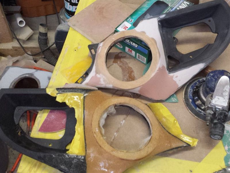

Posts: 60 Bradenton, FL | Some of you may of seen my thread on my Vision audio build:
http://www.vision-riders.com/bb/forums/thread-view.asp?tid=14983&posts=20&mid=152166
And I have had a few inquiries about the pods I built. They were a total pain in the ass to hand fabricate, had over 20 hours in each pod to get them perfect. I have however had several people inquire about them, and have been talking to a local prototype company about building a limited production run of them. Its not cheap, will cost me around $5000 for the 3D scanning, rapid prototype build and mold construction, but the end result will be a custom, yet factory fit speaker pod that will accommodate a 6.5' speaker with no cutting or modification at all.
With a projected price point of around $275 to $350 a pair, I would need to sell a few dozen of these to make it worthwhile. Anyone who might be interested in these, please hit me up and spread the word! I really need to be able to gauge interest in these before sinking in the $$ to fabricate them.
Shoot me msg if you are interested, the initial run will be for 25 pairs and I'd like to get pre-orders for all of them if possible.
If this works out, I will also be releasing a kit to allow a 6.5 speaker to replace the factory trunk speakers, as well as a drop in JL Audio subwoofer box for the saddle bags.

Posts: 60 Bradenton, FL | I used JL Audio MX Series marine speakers, which of course are waterproof, sound awesome and are designed for a "free air" or infinite baffle mounting. Basically if you try to use a small enclosure, they sound like crap, but removing the factory baffles and allowing them to "breathe" into the entire fairing gives great midbass. So essentially, the rear of the speakers are entirely open. I did place some small strips of Dynamat however on the fuel tank and inside of the plastics to help reduce resonance. They sound excellent in the Vision  |

| I have a few questions. Will these replace the existing panels or be an add-on of some sort? What color will they be, will they require painting? Will they use the original mounting tabs, screws, etc. ? Will the screw pattern just fit JL speakers or any 6.5" round speaker? Yours are made out of MDF and filler. Will the new ones require dampening? TIA

These will be direct factory replacements and will snap/screw into place exactly as the current pieces do. They will be pre-cut to accommodate any 6'5 speaker, but not pre-drilled since not all speakers have the same screw pattern or grille size. They will be made from black ABS plastic exactly like the factory pieces are.
I will ship the kit with several pre-cut strips of dynamat to place in specific areas in the fairing to improve midbass quality.
