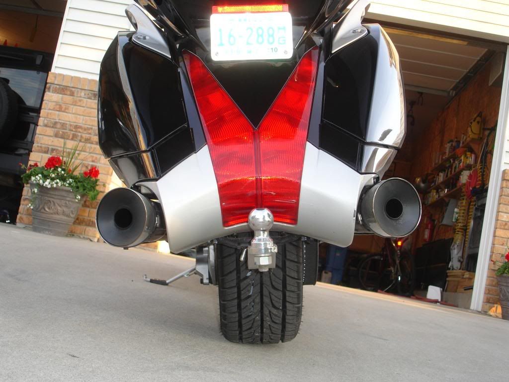

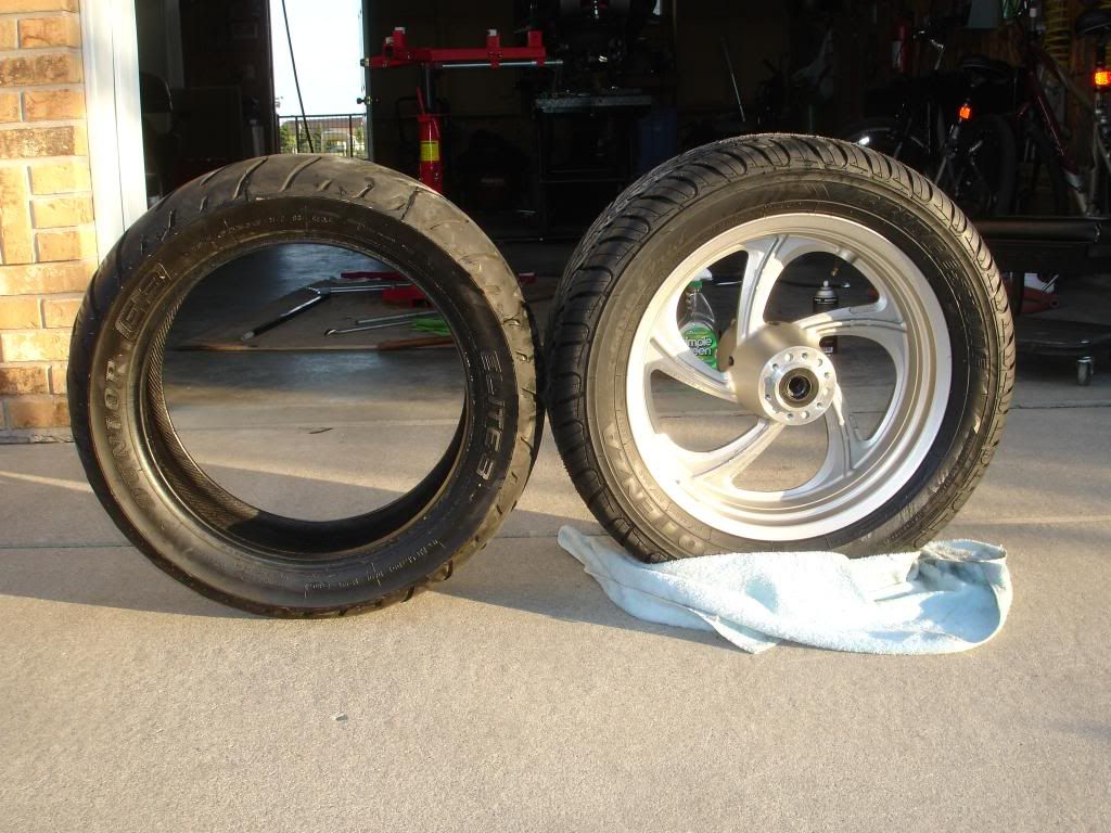

I have a Car Tire installed on my Vision with about 500 miles on it...so far so good.  I did run a car tire on my Kawasaki VN2000 and was very happy with it, so I thought I would give it a try on the Vision.  I ended up choosing a Bridgestone Potenza 195-55-16 as that seemed to be the closest to the stock size that I could find.  The tire was about $85 plus shipping and should last for 25,000 - 30,000 miles.  I have a hitch on my bike as well which makes the fitment a little tight but seems fine to this point.  I'm getting ready to leave for Sturgis and the mountains from there and will end up with probably an additional 3,000 miles in the next week or so.  I have Harbor Freight mounting and balancing equipment and did my own install and balance.  That went well.  The tire popped onto the bead with aproximately 20lbs of pressure.  I currently have 40 psi and will probably lower that slightly as time goes along.  The tire has not leaked down 1lb since install.
Here are some photos...
Side by Side for size -
  002.jpg picture by FlatsixV2

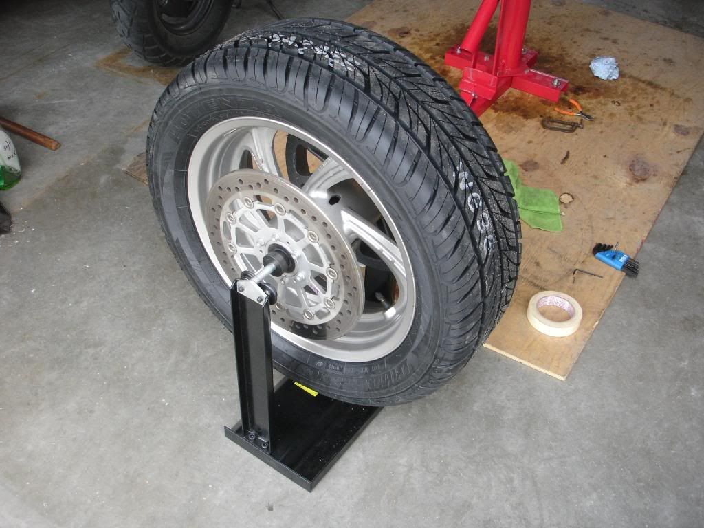

My balance job was better than factory...she rides awesomely smooth now -
 004.jpg picture by FlatsixV2
The finished product -
007.jpg picture by FlatsixV2
This post is for anyone that is interested in it's content.  I wouldn't suggest anyone else even consider mounting a car tire on their motorcycle and am not interested in hearing from those that don't think I should have done it.
YMMV

Nice job John.

Looks like a good fit, nice work. You have the HitchDoc hidden hitch? How much clearance wouldyou say you've lost as compared to the stock MC tire? I'm leaning Darkside (have been since I got the bike) for the next tire. Was going to do it on the first change but I wanted an accurate gage of how long the E3 would last without a bad bushing. I like it John.....

It does look like a nice fit.

thanks flatsix, now that I've seen it, it is not so bad. I think yours is the first one that I've even seen a picture of and was beginning to think it was an Area 51 deal. I'm going to hold out until I go with the trailer though, which will be some time from now, though I wanted it to be this year. I'm trying to get my wife to go long distance and I think that is what it will take.
