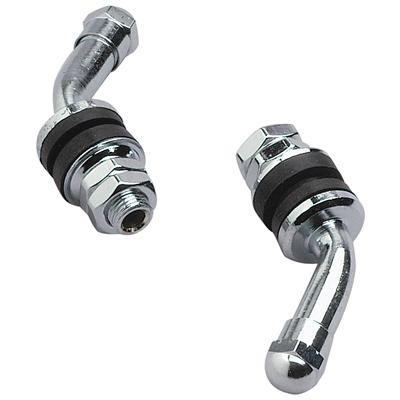

I bought angled versions and put them on last week. Got them from Kurveygirl on eBay or here:
http://kurveygirl.com/shop/index.php?cPath=27

Thanks John! I've been looking for a picture of that type of valve stem installed on a bike and it's good to see the tire pressure monitoring unit on it too! How is the clearance between the TPMS transmitter and the brake caliper?

The end of the sensor is over the flat part of the wheel. So there is PLENTY of room. SongFan had a thread about these awhile ago. I tried them and they work.
As for the sensor, I posted that very question over at webbikeworld.com and Rick the editor replied. See J.K. 8/09. With the metal valve stems, I am less concerned about an issue with them. With both stems now pointing at towards the right side, putting air in is a breeze.

11.3mm from KurveyGirl. http://kurveygirl.com/shop/index.php?cPath=27
These were taken on my 2008 VV. I hope the 11.3 still works on the new rims.

would this work ? http://wingstuff.com/products/29074-90-degree-chrome-valve-stem

Arkainzeye I used stems like that on my 07 Harley and they both failed. Both times were on the interstate and had to get a ride home, get trailer, go back for bike, then load with a flat. Thankfully no close calls or wreck, but it could have been BAD since wife was on the back for one of them.

Those are meant to be used with a support bracket, which is already on the Goldwing. Without the bracket, they'll fail. The stock rubber ones that Honda installs are known to fail anyway, unless the owner zipties the valve stem to the bracket.

Chris, just get the ones from KurveyGirl. Two of them are only $29. You're going to spend $22 for the ones you listed. The KurveyGirl ones are solid. No movement at all.

hey john, i stopped playing around and just ordered the same valve stems you recommended. (black) they look Very well made. im going to a CT very soon and i order the new stems and dynaBeads as well.. I just wanted to say thank you for the link(s).

HEADS UP EVERYONE... these KurveyGirl valve stems DO NOT work with the vision Black wheels.. the size of the black wheels valve stem is the exact size of the valve (the part you check for air pressure).

i should add the size for the 2008 vision is not the same size for the 2011.. from what i read the 2008 has the same size as the goldwing. my 2011 vision with Black wheel do Not have the same setup. the whole in the wheel is much smaller than a gold wings. i went to the dark side today and a buddy of mine that was also replacing his GW car tire to another Ct (28000 miles on the ct btw) his valve stem was much wider than mine when we looked at the holes in each others wheels...
