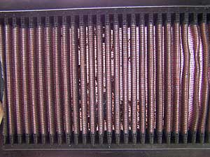

K&N FilterDirt has very sharp edges that cut and dig into all surfaces from the throttle valve to the valve seats and onto the rings and cylinders. Air filters must capture this dirt as air moves through the filter before it reaches the inside of the motor. This insures your engines components will not see the abrasive nature of these materials.
For all cotton and paper filters , the cleaner the filter the better the results. However, gauze and foam filters will actually perform better when slightly dirty, K&N, makers of high performance filters, use a gauze type element which supports a special oil to help further "catch" the oncoming particles.

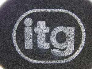

ITG filterThis design makes it so the oncoming debris that clings to the outside stacks or gets thicker as time goes by, reducing efficiency and air flow. Gauze elements offer increased airflow and higher power levels but at the expense of letting in slightly more fine particles when new. A gauze unit will perform better slightly dirty than brand new do to the thin lining of material.
As shown in the photo, when held up to light a gauze element will show openings or holes in the filter allowing the light to be more visible. This is the nature of such filters and the reason why they work better when slightly dirty. Slightly dirty they can catch more debris as it passes by because the surface area is increased from the trapped particles. Particles try to flow through the holes and are then trapped by the surrounding material and oil.
Foam Elements are thicker and need to be because of the cellular structure, almost like a 3 dimensional honeycomb. Foam filtration does very well in removing air born debris by having a tight cellular structure with stepped holes or openings. The particulates end up crashing into the structure as they try to move through it, allowing the oil impregnated element to grab all the debris leaving the air to move cleanly past and through the remaining structure.

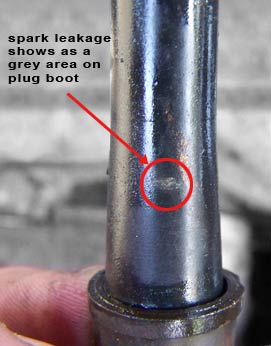

Spark plug wires also need to be part of the preventative maintenance schedule. While having a high energy spark system Victory motorcycles will use one of the first rules of electricity, following the path of least restriction. I have seen numerous occasions where the spark plug wires are ruined even on bikes with relatively low miles. This occurs for a few reasons. The largest I believe is caused by not having the spark plug wires end connector that snaps on the spark plug fully engaged. These connectors snap on VERY HARD and when installed don't always get snapped into place, because of the hard nature of installing these the boot gets pushed down over the plug with the installer thinking it's on. The end actually sitting on top of the plug and not on it for a short period gets worked upward from vibration. This moves the connection further away in turn giving the spark pulse a reason for finding a shorter path, this path will transfer through the boot and into the cylinder, complete combustion may not be lost at this time but will be if not caught. The boot will then show a grayish band right where the female plug connector is located. Over time you can see a burn right through the boot. Make the plug wires part of your maintenance.
