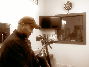

Lloyd examines a baffle before dyno testing the pipeI was asked by a very prominent individual to write an article on exhaust pipes. So thoughts just BLEW up in my head about how I was going to do that. Because I have that no holds barred attitude I figured it would be a good time to express some feeling on this topic and let some of you know what makes up a good exhaust.
