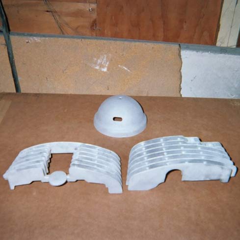

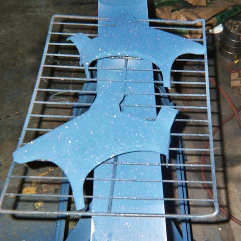

The powder in question is BASICALLY a powdered plastic. It is applied to the part with a low-pressure "fog", and is attracted to the part via an electrical charge imparted to the powder once it has been fluidized by the gun, and fogged onto the part. The part itself has an opposite charge to it, supplied by a ground clamp, so the particles are attracted to all areas of the part being coated. Make sense?

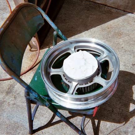

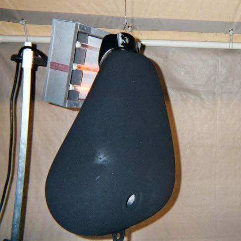

Now that the part has a dull coating of plastic dust, it has to be melted onto the part. The part can now be placed into an oven, or an infrared lamp can be used for this purpose for parts too large for an oven. I use an infrared lamp presently, as many parts are odd-shaped and I have no dedicated oven at present. This brings up an important point, and that is a DEDICATED oven must be used. This means you cannot be using your food oven for this! Otherwise your roast chicken will taste like powder coat.
To continue, once the part has cured, the powder coating will take on a smooth, somewhat orange peel finish to it. Some finishes do not have any orange peel, others just seem prone to it. Satin finishes, flats, all use the same process, the finish just turns out different, one from the next. Transluscents can be applied over chrome pieces, and are very smooth, allowing the chrome to show through the transparent coating, taking on its color. There are so many finishes available, it is hard to include all of them, but some available are: wrinkle finish, translucents, metallics, high heat, and gold vein.

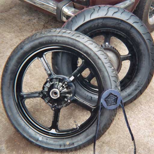

Once the part has cooled after curing, it can be used, simple as that. It is done!
