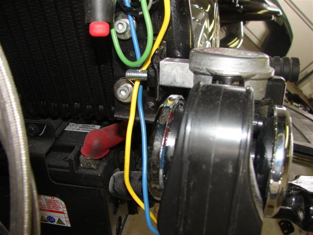

I don't know that this will help at all but here is an image of the stock horm mount.

Posted 2009-07-26 9:38 AM (#39887 - in reply to #39057)
Subject: Re: How do I mount the Stebel Nautilus?
That's a nice shot! Do you have one of the other side. This job would be a whole lot easier if i took the fairing off.

Wichita, Kansas
I mounted the relay to the bottom of the horn bell - less wiring that way. Pics in my gallery.
