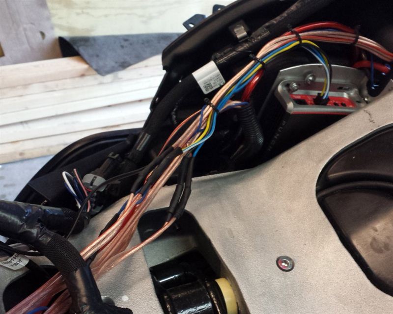

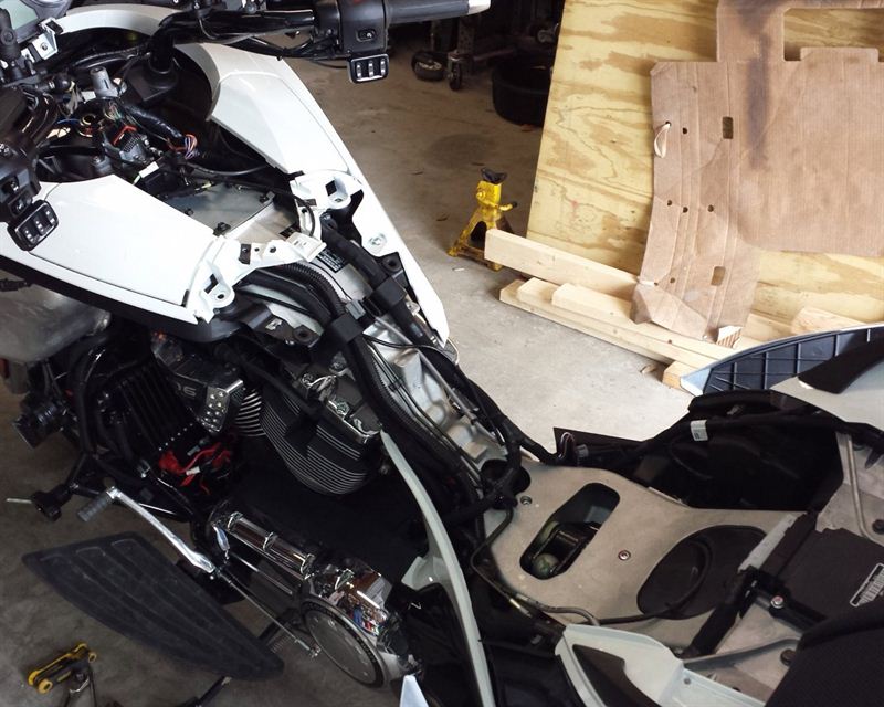

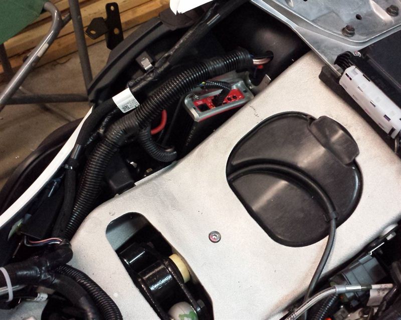

One thing the new scoot was lacking in, was the music department. I have my ipad mini for a source, but decided to add some upgraded sounds. I added in RF 2 channel amp for the mids/highs in custom bracket under the seat, a mono RF sub amp in the saddlebag. I fed everything with 8 ga wire and added in a power dist. block in the small cubby ahead of the right saddlebag.
I'll be posting more as the custom sub-woofer box and front speaker pods go in... still trying to get used to the thought of tearing down a brand new bike without even 100 miles on it yet for all this

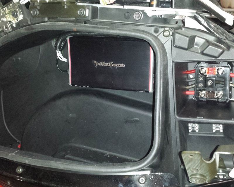

Word of advice about the amp in the saddle bag. You will need some kind of air movement for that thing because it will get hot and quick. Trust me, been there, done that. You're likely going to have to rig up some kind of PC fan and some kind of filtered air inlet.

Yeah, I am anticipating some potential heat issues. I am porting the sub cabinet outside of the saddlebag which I am hoping will give adequate airflow, but if not I do have a small DC fan on standby to install if necessary.

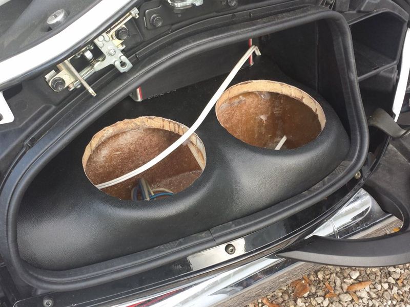

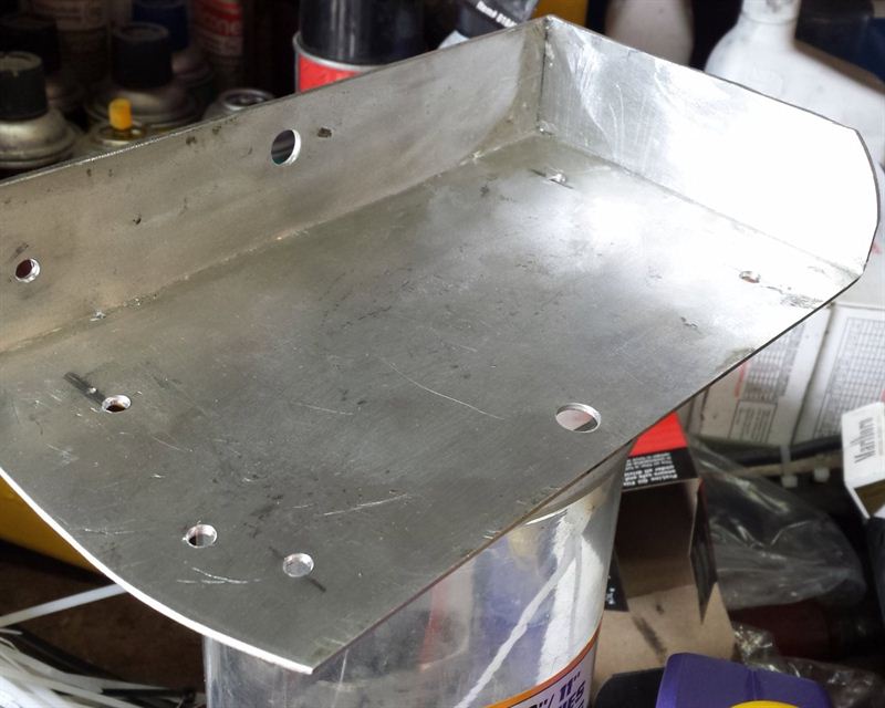

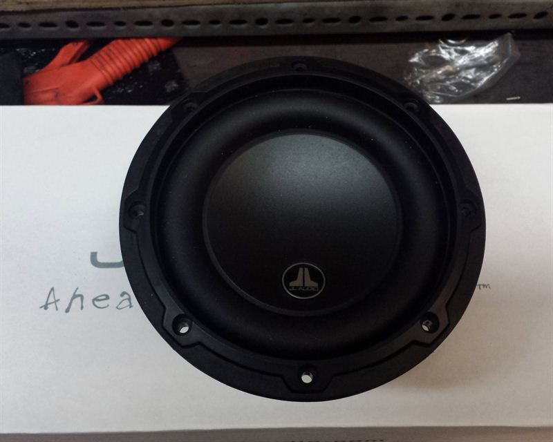

BTW here is sneak peek at the sub cabinet, will hold 2 JL Audio 6W3's. I wanted good sound, but didn't want to sacrifice an entire saddlebag for it. Will leave about 50% of the saddlebag still usable, and can be removed if necessary for long haul runs where I need the whole bag.

not just heat issues from the amp making heat. but inside those bags they get really warm in the summer.. figure where they exhaust in , where they engine is located, ive had stuff get REALLY warm in there. so add a amp and its a sure thing for your own little oven..

Yep. If you leave a cold six pack of beer in there from the store and have a long way home; it'll be tepid by the time you take a bottle out and crack the cap.

Yeah, for heat I am going to try using a small 12vdc fan and see how that works. If its not sufficient I will probably use a liquid cooled PC setup with a cool plate mounted to the amp, just have to find somewhere to mount the radiator for it.

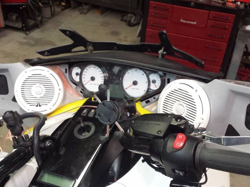

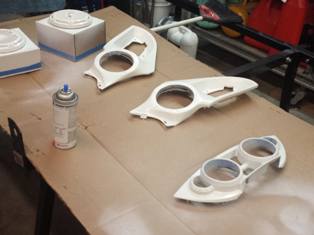

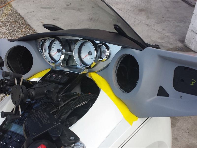

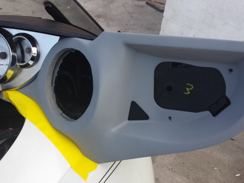

In the meantime, here is a sneak peek of my custom speaker pods for my 6'5 JL's under construction

Nice Work Bob. I enjoy seeing new ways of mounting speakers and amps. Noticed that you are running your +12 power line in the same loom as your input signal wires. You may run into a hum/buzz issue with that. Just an fyi.
Good Luck and take loads of photos! Consider writing a how-to article for this site.

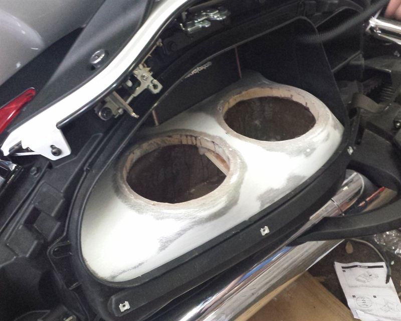

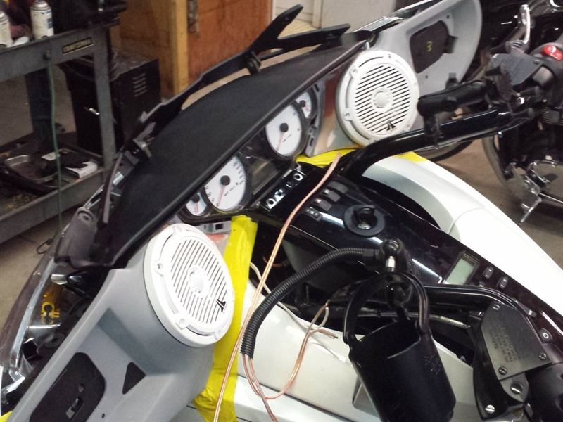

And the grinding continues... there is however light at the end of the tunnel!

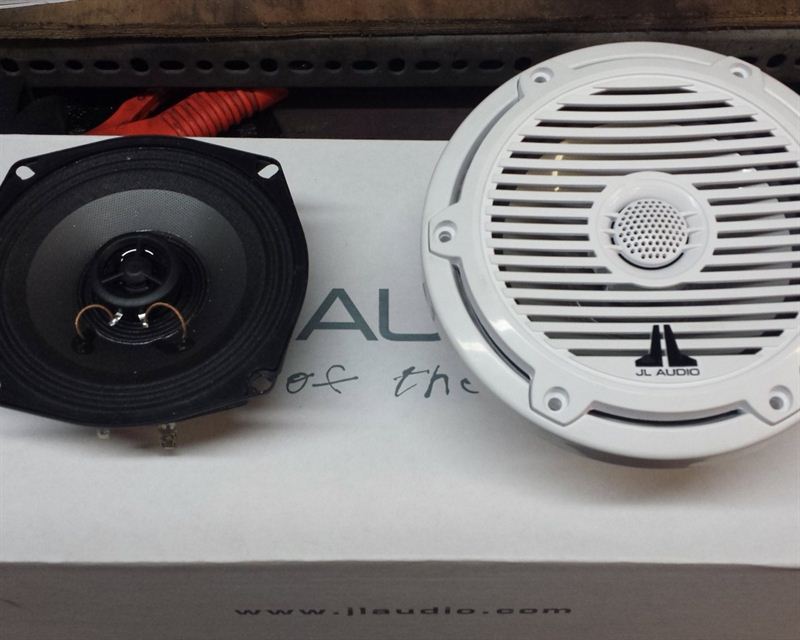

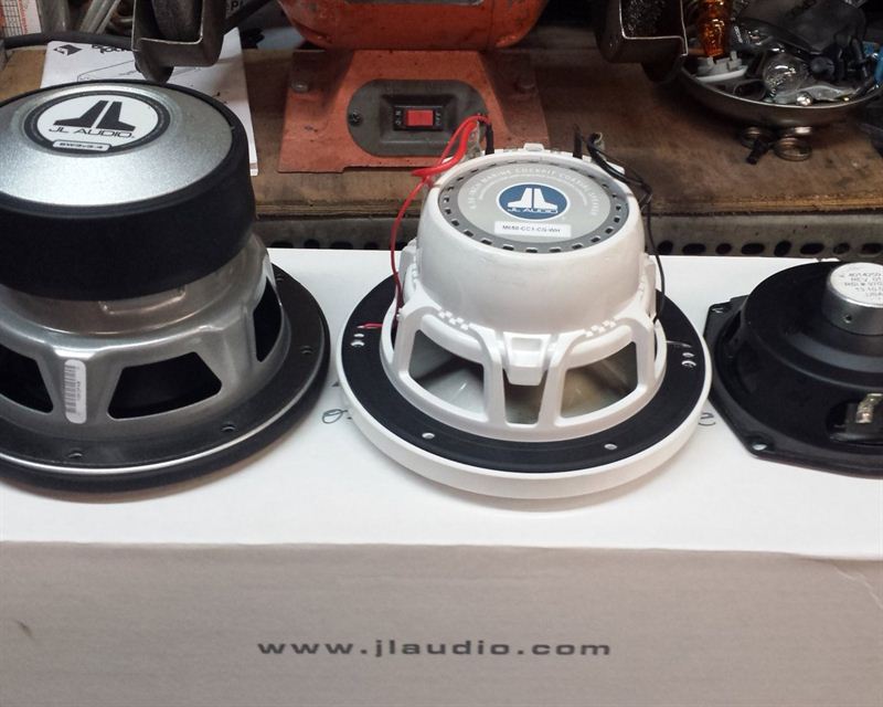

Here is a little comparison between the stock 5 1/4 speakers and the new 6'5 and sub. Just a wee bit o' difference as you can see

Your not putting speakers in where the mirrors are or am I head of you. Looks great
Before you put the seat on cover the shock hole with some duck tape it will help it to say clean around there.
I meet a guy this summer that had a small 4" fan down in front on the side aluminum trim that he would use to say cool when it got hot out. He said it was surprising how much breeze it put out

Ok, got the sub cabinet finished, system sounds great. Had to add some dynamat and port the saddlebag into the small compartment under the seat but the sound is very nice. Got all of the finish work done on the pods and everything test fit. Now its time for paint!

What are your front speaker pods made of? MDF?
And how did you get the smooth contours?

#1. Speaker pods are 3/4 MDF, fiberglass resin and bondo on top of the factory plastic panels.
#2. Lots of sanding!
#3. Because 2 are always better than one! And yes, they are both ran parallel to a single mono amp
#4. The sub cabinet is actually sealed and has about .6 CF of airspace which just happens to be perfect for a pair of the JL 6W3 subs.
#5. The port I made was from the saddlebag into the small unsealed compartment in front of it. It does create a bit of a bandpass effect, but more importantly allows the subs to breath and lets air move in and out of the saddlebag which in turn makes the subs sound better and helps to cool the amp located in the same compartment.

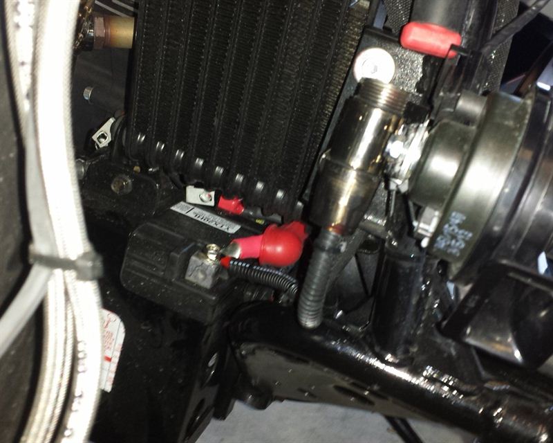

#5. The factory charging system wasn't as robust as I would of hoped. I ran all 8GA power wire, but did have some dimming lights when the system was cranked. I also noticed that running the system for not even 5 minutes with the bike off killed the battery dead. I added a second battery (gell cell, standard motorcycle chassis size) in the left hand saddlebag (one will easily also fit in the trunk mount, but I want my trunk to stay removable so thats why I went with the saddlebag) and now I get no light dimming at all, and thus far can crank the system up with the bike off and have no fear of killing it anywhere near as quickly.
