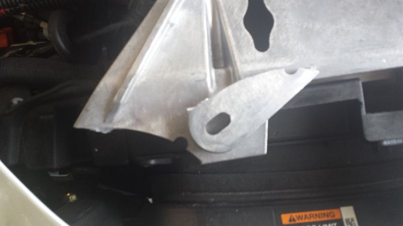

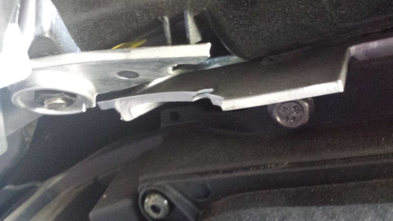

Well I have really been loving my bike, up until now that is. Had a failure in the most embarrasing way possible today... Was showing of my 14 Vision to some Harley and Honda guys. Set the bike on its side to demonstrate the skid plates and tip-over prevention. Had lots of ooh's and aah's, at least until I stood the bike up. I grabbed the handlebars and the rear grab handle and began to gently lift the bike back up and then CRAAACK! the grab handle ripped right off in my hand.
Needless to say when everyone stopped laughing at the great build quality of my new Vision, I simply rolled her back on home to assess the damage. Luckily none of the plastics broke, they just popped loose. I cant say as much however for the large aluminum plate that the handle bolts to....
Needless to say I am not impressed. After listening to my dealer on the phone, it sounds like it will clearly be a warranty issue, but sounds like it will be weeks in the making to get it fixed. It's a brand new bike with 300 miles on it AND its 3 days before Bike Week in Daytona which I had been planning on riding to...

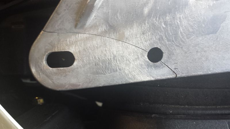

All I can say is that obviously there had to be a flaw in the casting, no way a big hunk of aluminum like that should of snapped. I only hope that I wont have to look forward to more casting problems considering the whole frame is aluminum as well!!
Has anyone else reported any similar problems, or is this an isolated incident?

Looks like there are marks from a grinder around the plate in your picture?
It definitely has swirl marks on it, but that's how it came from the factory.

That really is disturbing. As you mentioned, the whole frame being aluminum. Vic better do some serious investigating to find out how a flawed piece of aluminum got in 'one' of the bikes.

I had the same thing happen on my 09 a couple years ago. Fell over on some ice and when I went to lift it off the tip overs the same aluminum plate broke. I could have went through warranty but just bought a new plate rather than wait several weeks (or months) for Victory's decision if they would cover under warranty

A bad casting happens. We work with aluminum all the time. Doesn't mean any other pieces from the cast are bad. Could be improper torquing of fasteners and other things.
Yes, you even get bad castings in other materials.
Sucks that it happened. Have your dealer call Ma Vic and they most likely get it swapped out before you leave or have it done there.

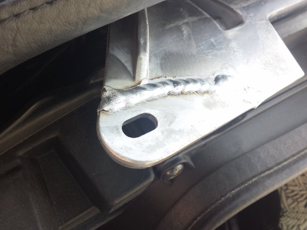

Take it to a good welder around town until the Vic dealer can fix it. Should only take a few minutes to tack back in place and then you can head down to bike week and no one will know the difference.

Yeah that's the plan, am taking it to a local shop today to see if they can TIG it for me.

My dads broke in the exact same way, but he was using an engine hoist to try and help him right it. He admits that he has had much better ideas in his life. Anyway ordered a new used one from evil bay, $75.00 and a few hours to swap it out. Dealer wanted over $300 for the part.

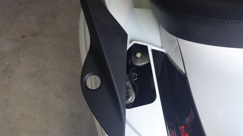

Well I did fix it myself, took the bike to a welder and had him TIG the broken ear back on. Reassembly was kind of a PITA and much more involved than I thought since you cannot get to the rear nut under the grab handle. Have to remove both pairs of latches on each side, unbolt the computer, remove all 8 bolts from the plate and use a pry bar to shift it up and over enough to get a wrench on the stupid nut. NOT a job I want to do again.
Moral of the story? Those stupid grab bars are nowhere near as solid as they should be so BE CAREFUL any time you use them to stand your bike up unless you want to devote an entire day to this stupid fix. Thanks Victory for making a great bike, but heres a solid FU to the engineer who designed these handles!
