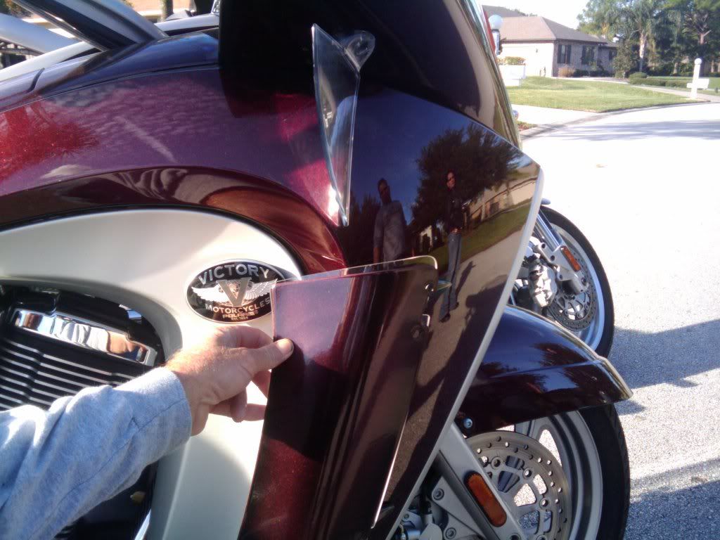

I too would disagree with the lowers being "stylish,...not an ugly.." I would like to buy them for their functionality but I just can't get past the looks. I just can't make myself tape big ole' ears to the side of my bike. For those that have them I'm sure you love them........I however just can't do it. I rather put ice on my balls if it's that hot out!
VisionTex
Posted 2010-01-30 8:21 AM (#52337 - in reply to #52332)
Subject: Re: Less heat on rider's legs without adding air deflectors
Posts: 1484
LaPorte,Tx.
I too thought they did not fit the styling of the Vision, that's why for two years I've not had them. But, because we get to change our minds, I now have a set on order. I think functionality is winning over on this one.

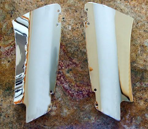

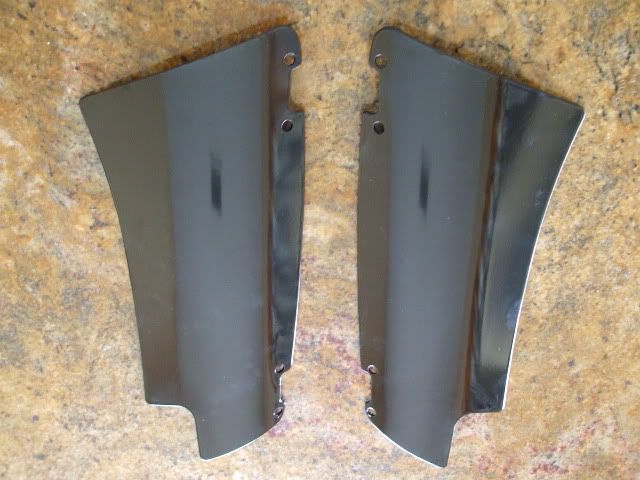

I agree the plastic ones do nothing for the bikes looks, especially when they're cracked or weathered/yellowed. On the otherhand, chrome never sucks! We also now offer these in the metallic Midnight Cherry as well as the new metallic Ocean Blue as well of course as our metallic Charcoal (SSG) and Gloss Black. Other colors available, as are raw prepped for painting the color of your choice.
Chrome uppers
Chrome Lowers
The New metallic Ocean Blue powder coat
Metallic Midnight Cherry powder coat
Gloss Black powder coat
Metallic Super Sonic Gray (charcoal) powder coat
