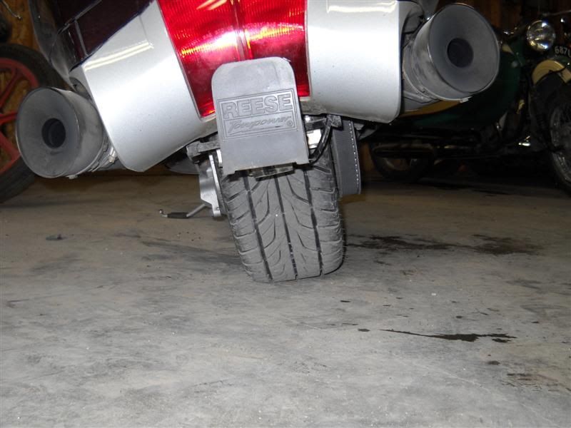

So.....basically if I want to do this, I need to stick with a 195/55 16 to be as close to stock as possible? And only be off by a 1mph or 2?
Another question....It seems that when coming to a stop on uneven pavement that the tire would alway be looking to level out. Im very short, 5,7 160 pounds and the bike is very easy to stop and I feel completely comforatable on it....even 2 up. Does a CT convert to more effort holding the bike up when stopped on unlevel surfaces going slow? I have found 2 dealers that will do this!
Can I also ask for some pics from some of you that has a 195/55 from the back?

I don't have any pics right now, but I have notices no differemce as far as wiggle or wobbles coming to a stop. It made a huge difference when I greased and my steering stem bearing. Much better when I got done.

http://img.photobucket.com/albums/v67/aaronrkelly/Vehicles/Picture0...

you'll find a car tire is not that of big deal. After a thousand miles you'll be riding like being on a bike tire. The only thing I really notice if there is a cron in the road I do get push or moved to one side or the other. Once you under stand that its a thing of the past.
Stoping is very easy and on windy days you balance better I think.
If your that short I would and wish I would have put the 175/60-16 tire on.
