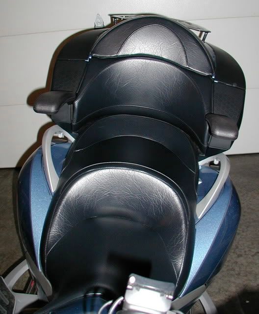

Lone Ranger - 2010-03-30 9:23 AM I like the look of the arms. Only thing is that for me, both arms would have to be able to pivot. Nice work!
Thanks....................Lone Ranger,
Both sides could be made to hinge up.
My wife always gets on the left side (kickstand side) so I made only the left side hinge up
Tom

ScoreBo - 2010-03-30 4:59 PM I love the looks of these. The Vic ones look like a wheelchair bolt on cheesy version. I will not buy these. Tom, on the pivot point, does it move freely or is there a bit of rubbing on the back seat pad? It looks like is more separation between the back and speaker grill when the armrest is in the upright position.
Thanks.......................... John,  I really like the look too!
Yes when the left side is pivoted up the arm steel rubs on a protruded plastic rib on the back of the back pad.
It doesn't seem to hurt anything and provides a clearance gap.
When the arm is lowered I noticed it was starting to rub the vinyl so I screwed on a little wear plate
Tom

Nice mod Thomas. (got your fork bullets installed by the way) I was looking at the ~ 1/8" gap between the seat and the sides of the speakers on my vision and my only concern is wear/tear on the side of the seat/speaker housing from moving the armrest up and down. How about a thin rectangular slot mounted to the side of the speaker in which the arm rest bracket would pass thru and allow movement up/down. The slot would create a gap between the speaker and the seat and prevent the armrest bracket from rubbing on the sides of the speaker or seat. Just a suggestion....
Posted 2010-03-30 9:21 PM (#56134 - in reply to #56122)
Subject: Re: Passenger Arm Rests (homemade)
nailer - 2010-03-30 8:30 PM Nice mod Thomas. (got your fork bullets installed by the way) I was looking at the ~ 1/8" gap between the seat and the sides of the speakers on my vision and my only concern is wear/tear on the side of the seat/speaker housing from moving the armrest up and down. How about a thin rectangular slot mounted to the side of the speaker in which the arm rest bracket would pass thru and allow movement up/down. The slot would create a gap between the speaker and the seat and prevent the armrest bracket from rubbing on the sides of the speaker or seat. Just a suggestion....
Thanks..................Nailer!
Hey your the first guy that I know of that did my fork bullet mod , way to go, how did they turn out?  I what to see a pic
I think your right the gap could be almost eliminated with a slot taken out of the speaker grill.
First I think the arm steel could be bent more exact and then maybe just a 1/8" shave of the speaker grill would be in order.
Tom

First and foremost, Great job and great mod!!!!
I was thinking about the pivot point and thought that if a larger bracket was made the pivot point could be closer to the middle of the speaker area. This would put less force on the stop when the arm rest is down. I will see if I can mock something up.
The bracket would be larger but the arm could swing further up. Possibly the bracket could be two pieces....a left and a right with the arm pivot bolt going through one side, the arm and the other side. That would protect the seat and speaker from the pivoting of the arm.

First and foremost, Great job and great mod!!!! I was thinking about the pivot point and thought that if a larger bracket was made the pivot point could be closer to the middle of the speaker area. This would put less force on the stop when the arm rest is down. I will see if I can mock something up. The bracket would be larger but the arm could swing further up. Possibly the bracket could be two pieces....a left and a right with the arm pivot bolt going through one side, the arm and the other side. That would protect the seat and speaker from the pivoting of the arm. Ride Safe!
Thanks.............................Paul!
I agree with your thinking the pivot point can be located closer to the speaker area.
It's going to be interesting what you come up with
Tom

Sorry John,      Just can't resist, two pics for you. LOL!
I'm trying a different set of pads (inch longer but thinner) that I was able to get off of an older office chair.
I think I like the original ones  better
Tom

Still have a few adjustments to make, but I like them and my wife loves them, thanks Thomas for the idea and the excellent pics, was an easy project, I made both sides able to swing up.
