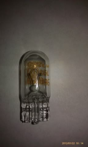

Hey Guys,   Big Steve wants to light up his trunk lid taillights.
The Vision that he owns was sent to Europe missing the trunk lid taillight bulb socket(s).
I took several pics to help show what he's looking for.
I looked on several internet sites and was unable to find the exact socket(s).
I live in a rural area making it inconvenient to physically check out part stores.
Taking the trunk lid taillight out is a simple task with only two screws.
So I'm asking if someone could try and find the bulb socket(s) or even a different one that would fit the cut-out hole in the trunk lid taillight for Big Steve.

Are there any markings at all on any of the parts? That might be helpful in finding the source.
Can you tell me what bulb is used? (T1, etc)
Edited by cchristo 2012-01-22 10:04 AM
Posted 2012-01-22 10:31 AM (#105867 - in reply to #105866)
Subject: Re: Trunk running light pic req'd
cchristo - 2012-01-22 10:02 AM Are there any markings at all on any of the parts? That might be helpful in finding the source. Can you tell me what bulb is used? (T1, etc)
The female end of the bulb socket that is attached to the wiring harness has EPC with the number 4 on it.
The bulb appears to be maybe a 5w wedge type. Marking are 0512V w   E1 2GL  W5W896
