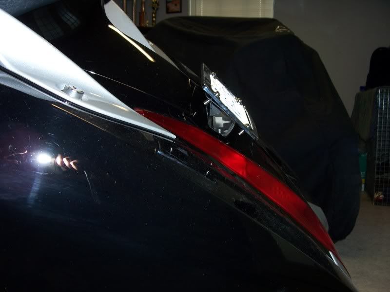

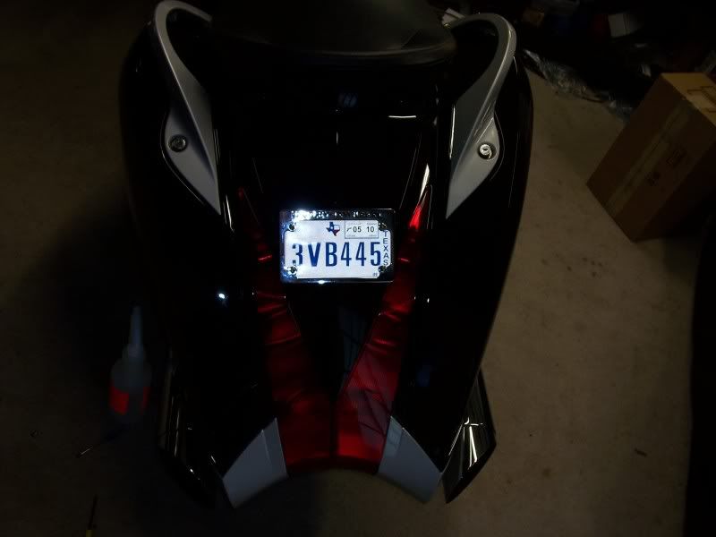

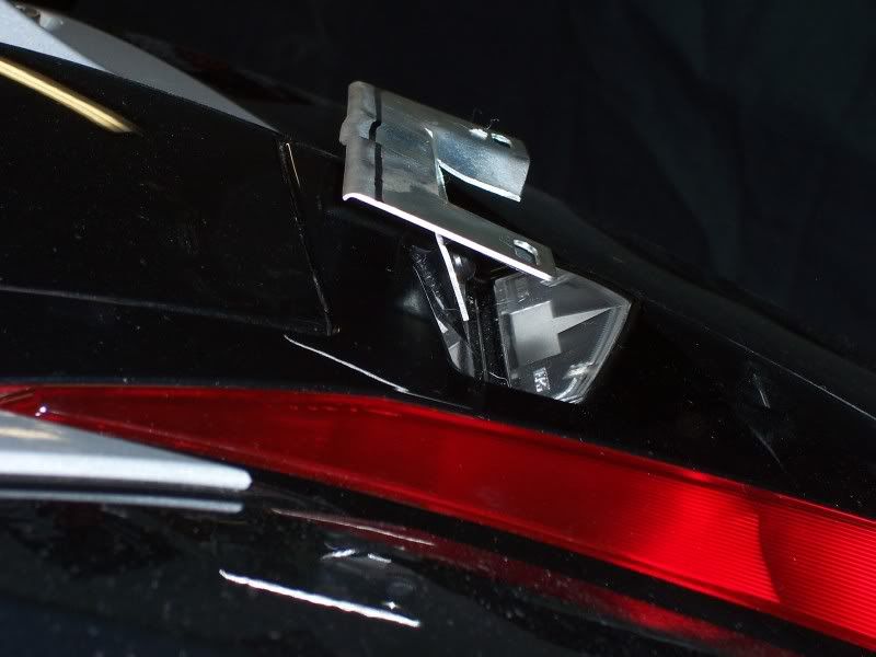

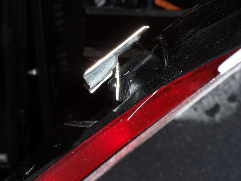

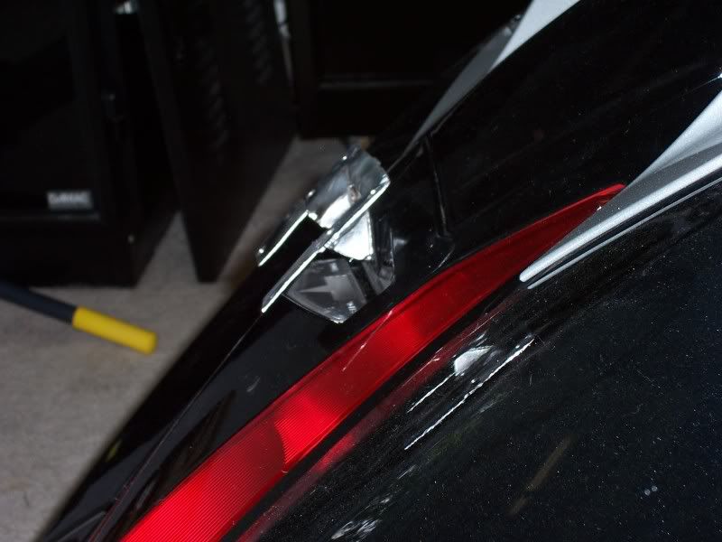

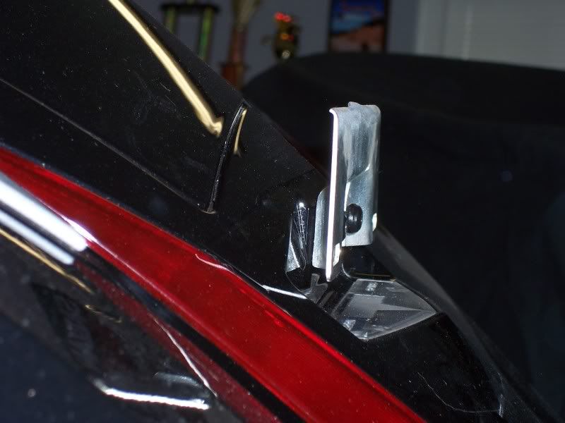

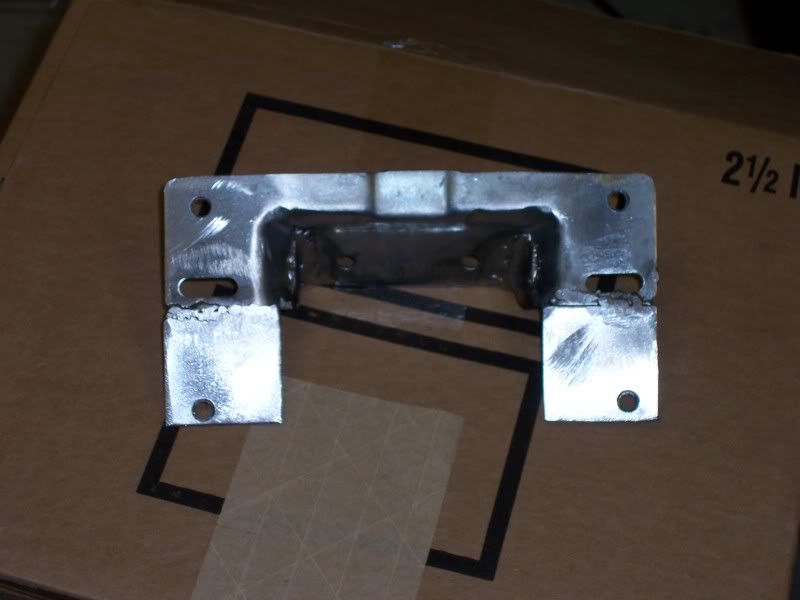

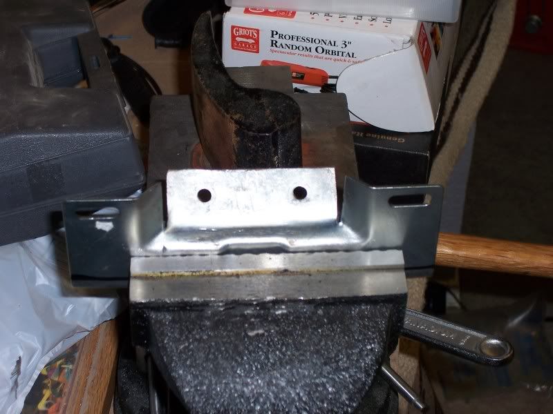

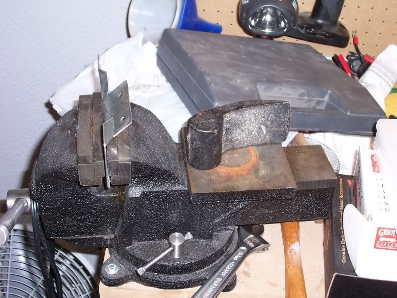

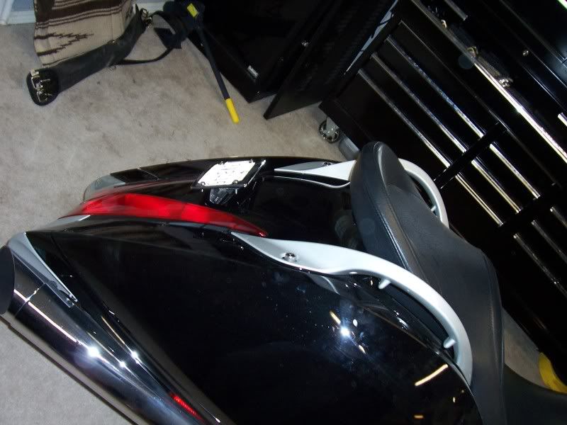

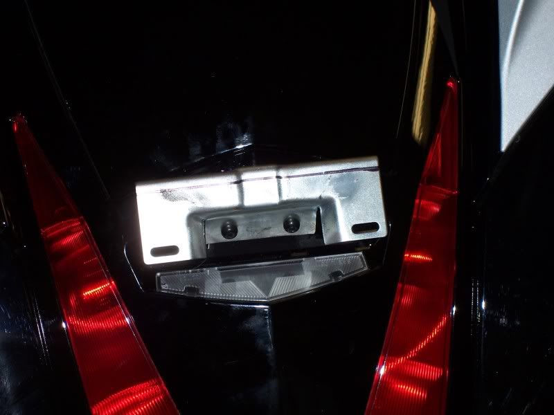

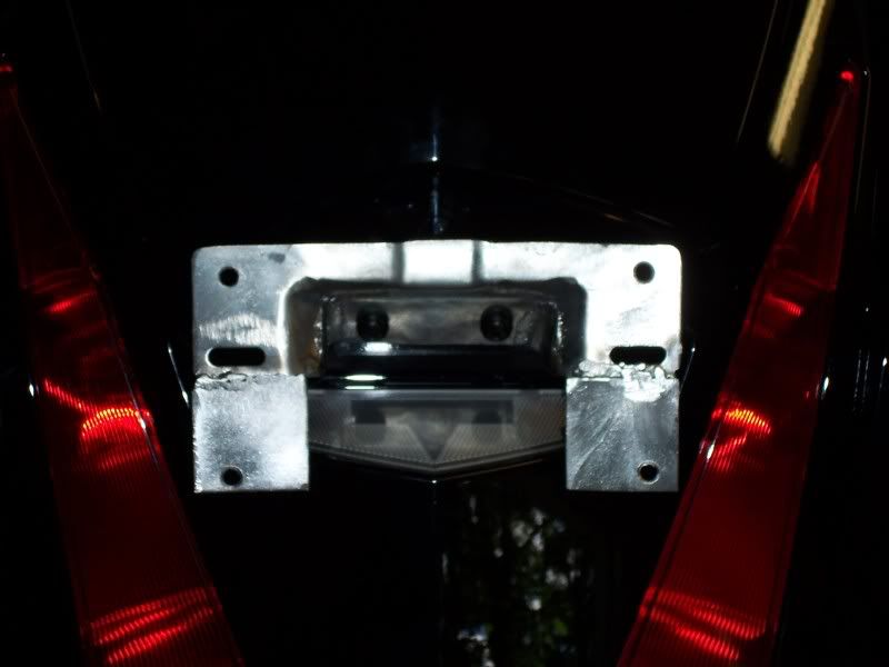

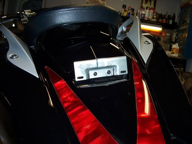

I am new to the VV world we have had mine for a few months now and have been looking for a laydown license plate bracket since before I made my purchase. I have contacted Arlen Ness a couple of times, but my calls and e-mails go un-answered and well I see that others have never found a solution either so I finally sat down today and made my own.
Here are the results. I ordered a LED frame this afternoon so I will post another pick when I get that on for now I just put a chrome HD one on for a mock up.
Let me know what you think... Oh and yea I know the bike is filthy.
Jeff
http://s181.photobucket.com/albums/x252/jskwarek/2009_08_01_Victory...

Yea I knew of the straight on from Arlen, but just don't like the looks of it. My dealer couldn't find the part, but I don't think he looked very hard. I have looked all over, sent Arlen's Customer Support e-mails and left VM's as they don't answer the phone I just gave up. Mine cost me 20 bucks in materials. Also the one I did sits lower and shorter on the rear fender then the one he has on his custom VV so I don't have to take off the plate when I take the truck on and off.

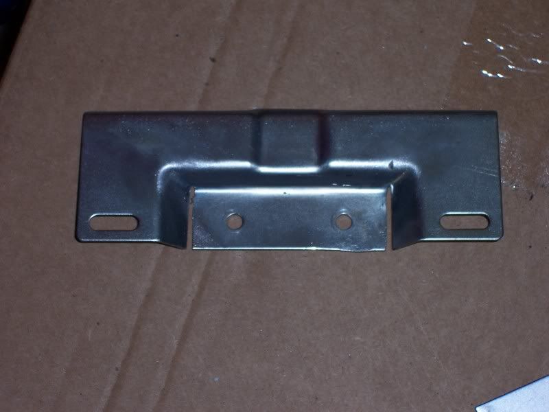

jskwarek,
Thank you very much for documenting the lay down license bracket. This is the best license plate frame that I have seen for the Vision.
Did you start with the stock frame and modify it?
Thanks again and Ride Safe.

Correction to my previous post... I did know about the straight license plate frame and look at them up close it is the lay down part that I couldn't find.
RadioTeacher,
Yes I started with the stock bracket. I thought I was going to have to make one from scratch but when I got started it was easier just to modify the stock one. Now that I have the first one done, I think I can make a block that mounts to the bike that will allow me to use any after market frame, I am going to start playing with that as well.
Jeff

jeff, how well does it illuminate with the plate light? In Va we have to have a lighted plate and it seems it would block the light.
jskwarek
Posted 2009-08-03 9:32 AM (#40753 - in reply to #40676)
Subject: Re: LayDown License Plate Bracket
Posts: 30
Blocks the light totally, we have to have the same thing here in Texas. I ordered a black poweder coated license plate frame online that has a built in LED strip that I will use for a plate light and will will tap into the existing license plate light for wiring since I am centered above it. That is the next step and in my opinion was the easy part.
