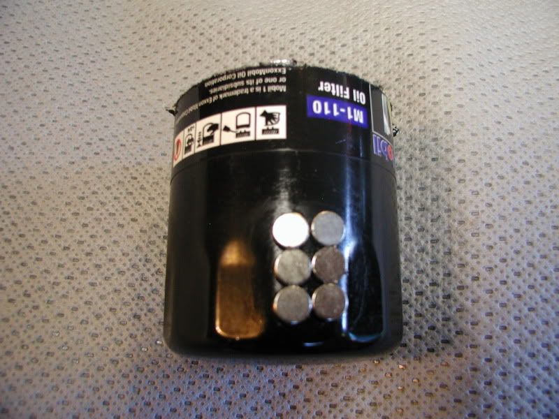

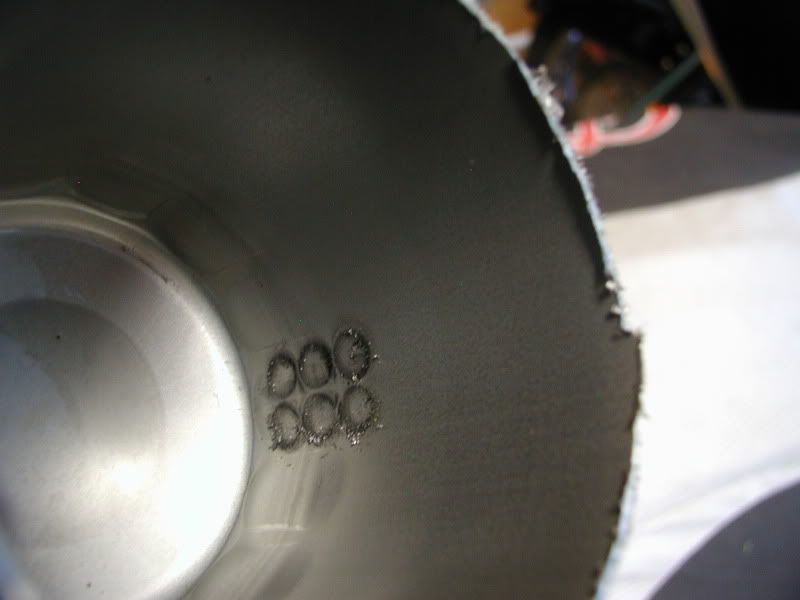

I've been putting magnets on my filters for a long time,along with a magnetic drain plugs, and the Vision is no exception. Did an oil change this evening(11,300miles) and just for grins cut the filter open to see if the magnets were catching anything-they were. the drain plug had it's usual coating of magnetic mud-very light nothing unusual. The filter also mirrored the magnets after rinsing with gas-see pics. It certainly doesn't do any harm and I'll continue the practice-Brian
some of the big metal particles are from hacking the filter open

If you were to use a pipe cutter, you will not have all the shavings from the hacksaw. Just what I used the couple of times that I have opened the filter to see what they looked like inside. ET

Just out of curiosity, does the oil flow through the filter from the outside toward the center or visa versa?

Oil flows into the filter through the outside holes and returns back through the center hole.
Any particles that are big enough to see are certainly trapped in the filter media if the magnets were absent.  This is true, else all the folks that didn't use magnets would have short lived engines.  The particles in the images are big enough to trash bearings and score cylinders if they made it through the filter media.
That being said, if it gives peace of mind to stick magnets on the filter, by all means do it.

Hey, Willie... It sounds like we are on the same page re the magnets. I suppose it is possible that the magnet could pick up some minute particles that the filter might miss, however I'm thinking that filter manufacturers would put magnets on their production filters if they thought there would be a significant benefit. My magnet is on my pan guard to activate traffic signal loops.

I also have a magnetic oil plug in the Vision and it usually has a bit of metallic mud on it at oil change inspection-so there's still some things circulating that may take several passes through the filter that it's catching- like I said it certainly can't do any harm and I like to see what's getting caught by them.

Welcome to the forum, Stevego2. The clear definitive answer to your question about whether the magnets work is: maybe a little. The info above indicates that they do catch some metalic material from the oil, so it might pay to put a little magnet on your oil filter. The jury is still out on the traffic loop issue. I put a powerful rare earth magnet on my belly pan, powerful enough to draw blood if you get a little fold of skin between two of them, and it seemes to help activate traffic signals, but not 100%. I'm thinking that the width of the magnetic field may be a significant factor for activating the loops, making four wheeled vehicles more effective that two. I would like to hear more on the subject.

It's standard practice on light aircraft to cut open the filter when you're doing an oil change (usually @ every 50 hours of operation) to do a visual for chunks like chrome, bronze, copper, etc. which, along with an oil analysis program will give you a good idea of how many hours you have left on an engine (rule of thumb on one is around 2500 hours, and upwards of $50K + to overhaul one). If you are concerned about the engine 'making metal' it had better make some, just like you should be suspicious of any engine that doesn't use any oil. Want an example of normal amounts of sump metal? Go do an oil change on an air cooled VW BEETLE for those of you who forgot what looks shocking but is perfectly normal levels of metal.
Use magnets if it makes you sleep better @ night, but I put magnets in the same category as the old toilet paper after market oil filters sold years ago by FRANZ. Stay on a regular schedule for changes and don't let the dealers service department sell you anything 'extra' while your bike is being serviced, the 'extra' are simply there to pad the dealers profits as part of whats described as a 'package' when you buy a new car (undercoating, paint protective coverings, etc.) you really are wasting money having the air inspected in your tires or other strange sounding, redundant things on a very long list presented by the service writer, any questions or disagreements? Just hold up your owners manual open to the applicable page and ask 'isn't what the manufacturer recommends all that's needed?' If it ain't on the factory recommended list in the manual for the interval involved, it's just 'mo dough' in the dealers pocket. And as we all know, if you want to rob people legally, throw your gun in the river and open a motorcycle (or marine engine) shop, plus you get to charge sales tax too!

Aluminum, Copper, bronze and bearing antimony are amonst the metals that ARE NOT magnetic so you aren't getting a true story by using magnets.

We have to remember how an oil filter works; the oil enters from the outside and travels around the outer shell to the inside of the filter through the filtering media. The filtering media will stop any particles larger than 4 or 5 micron, smaller particles pass through the filter. The filtered oil is channelled throughout the engine through the oil galleries. If the filter gets plugged with contamination, the bypass valve will open allowing the oil from the sump to bypass the plugged filter, this is done so that the engine is not starved of oil if for some reason the filter plugs with debris; the down side to this is that you are pumping unfiltered oil through the engine. Will a magnet pick up the particles of steel which are small enough to pass through the filtering media (less than 3 or 4 micron)? I would think that they would. In my opinion copper, aluminium or brass are less harmful to the engine, due to their softness and are less likely to score anything they may come in contact with. The filter should capture the larger than 4 micron, non metallic particles in the oil.

1 micron = .000000001 in diameter, it takes 25400 microns to make an inch, the averge oil filter will handle particles to about 5-8 microns in whats refered to 'single pass filtration tests' so you might as well put a magnet between your butt cheeks before you ride for all the good they do.
The reason you put them in cows is so they don't perforate a gut by swallowing wire, staples nails, etc. But if putting one on your oil filter makes you all warm and fuzzy, by all means drive on, I'll leave the old wives tales alone.
The reason an aircraft mechanic cuts open a filter is to see what sort of metal the engine IS making (and EVERY engine makes some) so you can perhaps get the engine to overhaul before it fails if it's making bearing metal, and the only place you SHOULD find small traces of metal would be in the outer shell, not in the inner side of the filter media where the oil returns to the oil pump via suction and then to the bearing surfaces again.
