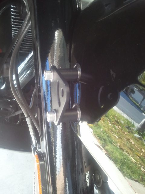

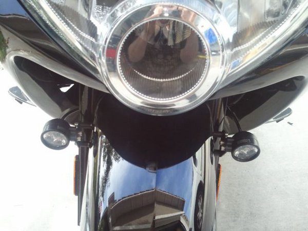

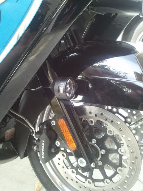

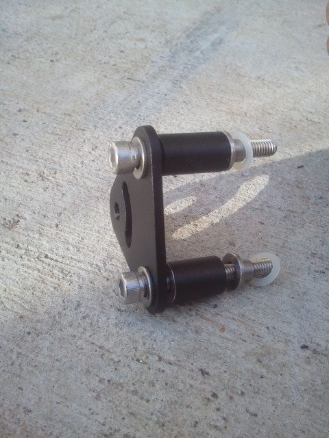

The lights are mounted to the fender by replacing the two fender bolts in front of the forks with the mounting bracket;
I found that the front fender was to loose with the provided setup and I needed to purchase M8 zinc coated washers (4 total) to slip onto the step washer before the nylon washer. This made everything snug.

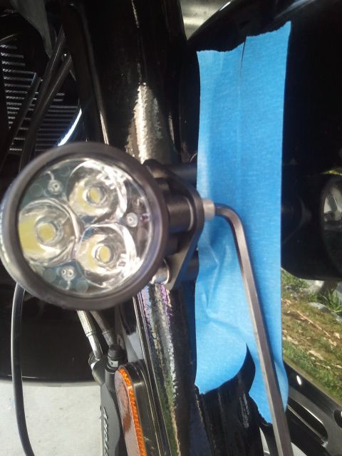

When attaching the lights to the bracket, you will find that the allen wrench is to long. Tarpits99 buddy Milton came up with cutting an allen wrench down to fit. I also recommend protecting the fender with masking tape while tightening these bolts;
Finish by running the wires back and zip-tying to the brake cables and running them up to the dash making sure there are no restrictions when bars are turned fully in either direction. The included instructions are easy to follow for wire routing and light adjustment.

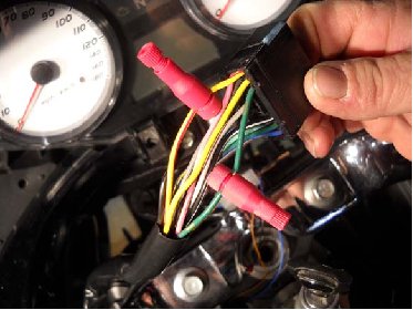

When connecting the white wire to to Highbeam wire, you may find it is either green or blue. My 2010 is green, just make sure it's the wire that goes into the harness at position #3.
You can also have the lights go full bright when you hit your horn. The wire for the horn is the gray wire and goes into the harness at position#8

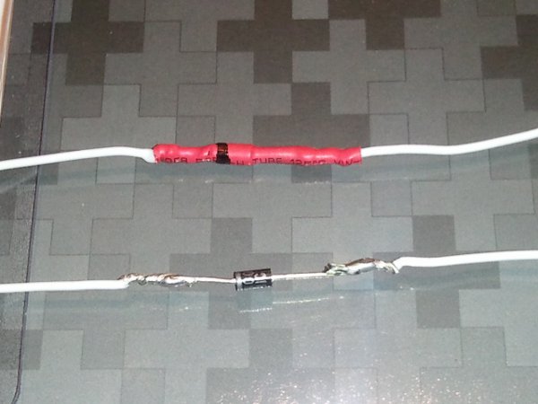

If you want to have both the Highbeam and Horn option, you will have to make a trip to Radio Shack. You will need (2) 1 amp diodes, part #276-1653. Splice these into two wires that you will use to connect from the white wire on the dimmer control - one to the Highbeam wire and the other to the Horn wire. make sure the "cathode" side (the side with the stripe) goes toward the dimmer.
The bottom wire shows the diode before it is covered in shrink-tubing. Make sure you mark the shrink-tubing with wich side is the "cathode" side.

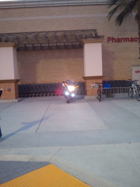

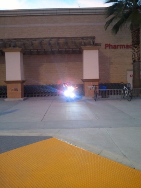

Here are two pictures of the Glenda from head-on, one at minimum and the other at maximum power.
This has been one of the best accesory for safety that I have added so far.The triangle pattern the lights emmit to oncoming traffic make the bike very visible. Nighttime riding finds that the lights fill in the area below the low beams for a greater field of vision. It does seem to be a fairly narrow pattern though and I'm working on a way to widen it a little.
