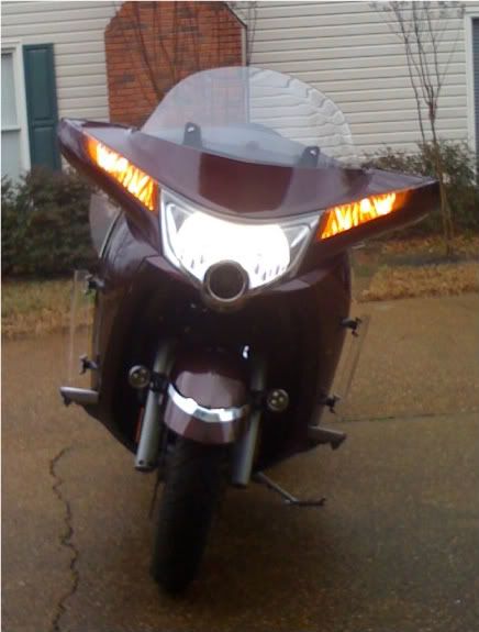

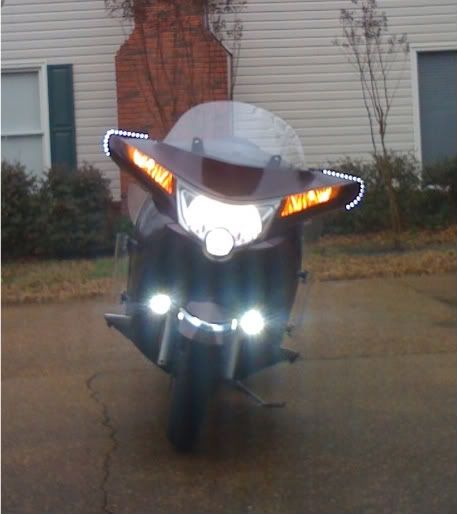

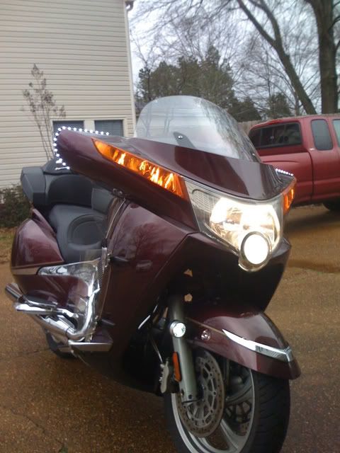

Rainy day project.
Low headlight beam only.  Can you see them?........
Photobucket

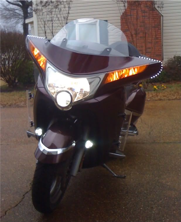

Ok, I'll add the Clearwaters.  How about now?..........
Photobucket

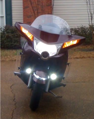

Ok, last clue.  Let's light up the HID.......
Photobucket
Photobucket
Photobucket

A little photoshop night-vision.  Ever since I color-matched the big access panel under the windshield, I feel like I gave away about two feet of visibility to oncoming traffic.  That huge aluminum "flying v" is visible a long way off.  These LEDs make me look four-feet wide again.

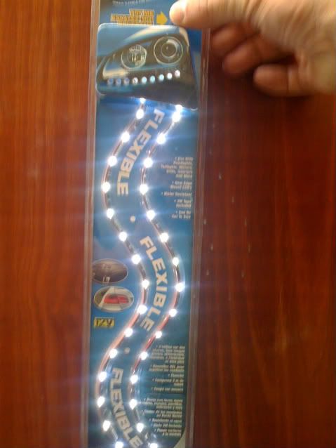

I didn't make a big deal out of this for several reasons.  1)  Not convinced on the quality of the LEDs.  $27.00 at AutoZone (also in Canadian WalMarts).  Obviously Chinese made and not blacked out.  You can see the wiring/diodes between each LED.  Not sure what to use to paint them black that would last.  2)  I drilled a hole in the bottom of my right fairing to run the wires on that side (not a popular option).  3)  The look.  It looks like I highlighted its "ears".  I was going for something more menacing.  Having said that, women and kids think it's the coolest thing ever.  Is that a bad thing?
They come with 3m brand tape on the back.  They stick really well.  I PosiTapped into the Pink/Green wire coming off the HID switch.  I could do this whole thing in about 20 minutes and I can undo it in about 2 minutes (not counting scaping off the tape/cleanup).  This is just a little experiment that I may or may not keep.
I can see a faint glow through the clear strip since it is not blacked out.  It is not distracting at all.  No direct light from the LEDs from the saddle.
28" White LEDs.  (2 - 14" strips)
p.s. - The "glow" from each lit LED is about 5 times the width of the actual diode.  That's why they look photoshopped.  The strip is basically invisible head-on when mounted and unlit.  About as thin as a dime.  I would say 3 or 4 times thinner than the strip used on the MOABL.  Very cool concept and amazing amount of light for their size.  Each LED is about as big as half a grain of rice.
Photobucket
Photobucket
