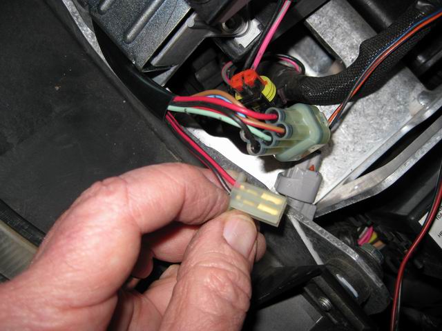

Connector under tank cover meant for a powerlet. A male flag connector will fit in the grey/pink slot and provide power for accessories without cutting wires. 20 Amp max. Runs off the horn fuse which powers the powerlets.

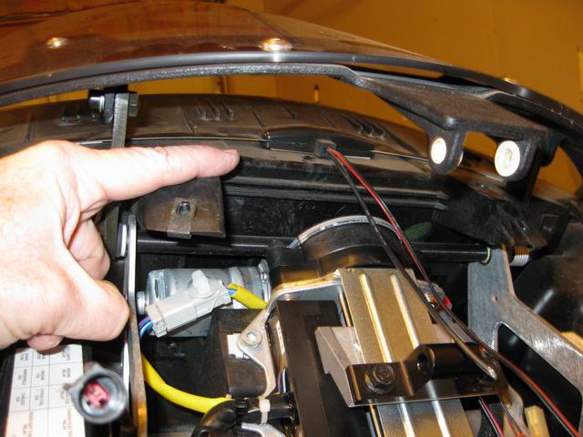

Extra Connector on the Windshield Motor

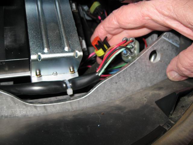

Amplified Antenna Power Connector
AM/FM Amplified Antenna Under the Instrument Panel Visor
