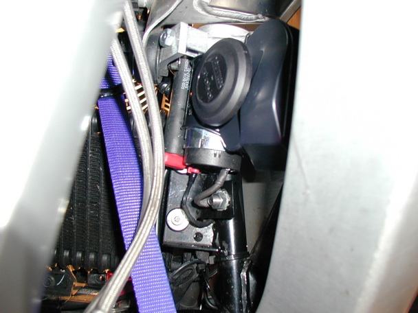

Stebel Air Horn clears brake lines,fairing and grill:)

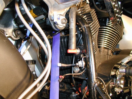

20 amp in line fuse

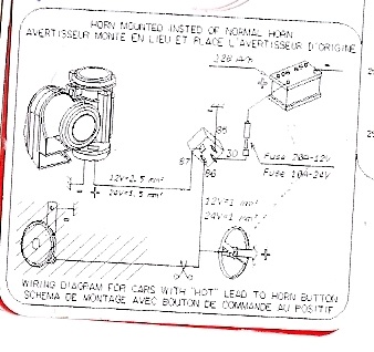

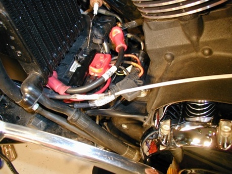

Wired horn (+) to #87 on relay - horn switch (grey wire) to #86 on relay - grounded #85 on relay - power from battery side terminal to #30 on relay with an in line 20amp fuse.

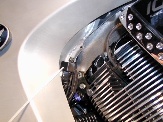

Bolted horn relay up out of the way.

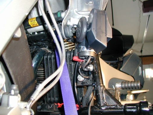

Stebel Air Horn mounted to 1/4" thick aluminum bracket.
Made a bracket from 1/4" x 1" x 2 1/2" aluminum. Bent the bracket at a 40-45 degree angle. Which allows the brake lines to clear the air horn. Drilled two holes in the aluminum bracket and mounted using one of the gas tank bolts. Grounded the horn using the factory horn location.
