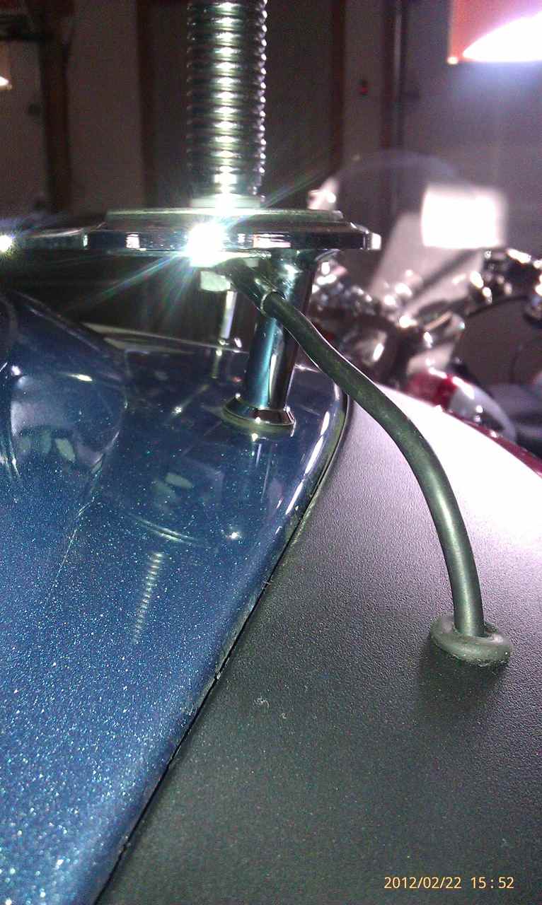

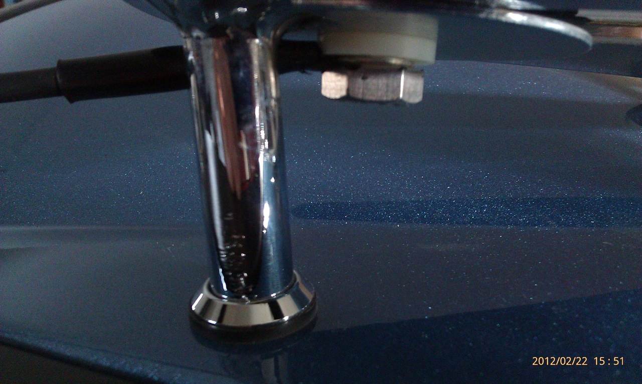

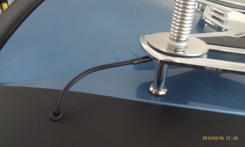

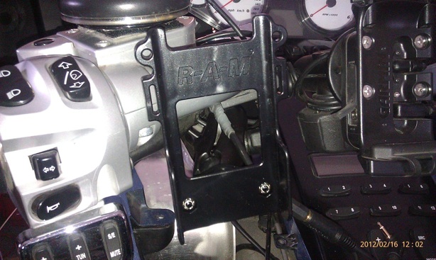

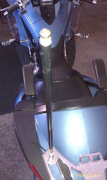

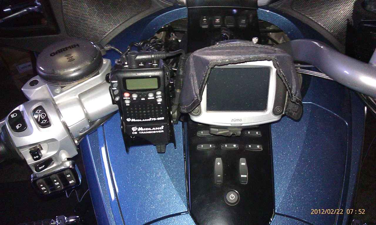

Mounted a Midland 75-822 CB using a ram-mount universal belt clip bar holder and installed a 2' Firestik NGP antenna on the trunk luggage rack.

Purchased the 2'Firestik Antenna from here... http://www.amazon.com/gp/product/B000X39SPW
More information on the 2' Firestik antenna http://www.firestik.com/Catalog/NGP_Roof.htm

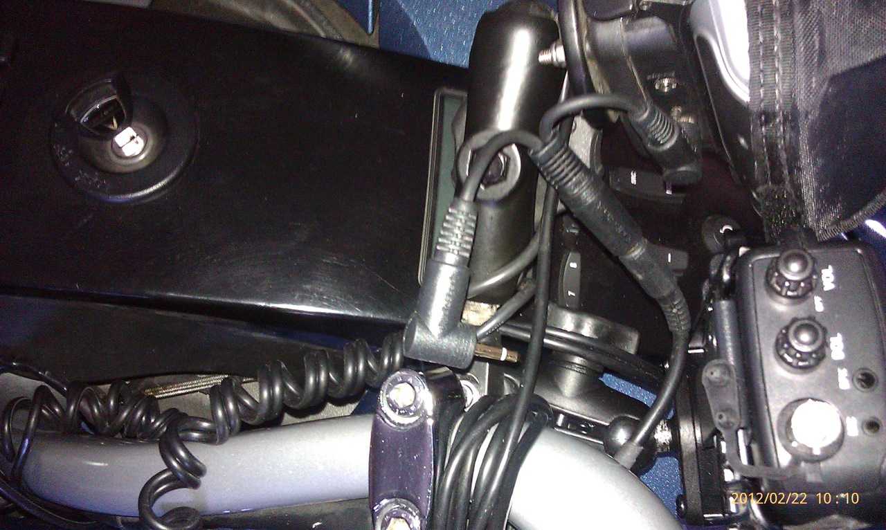

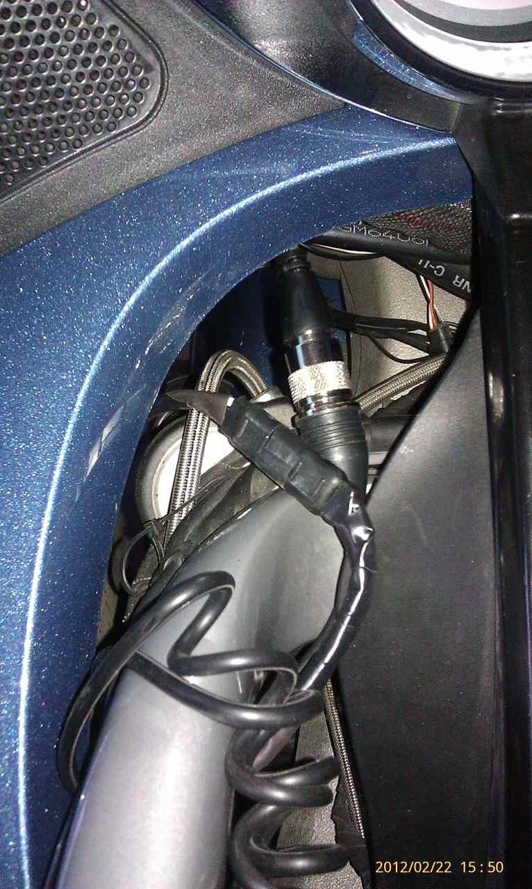

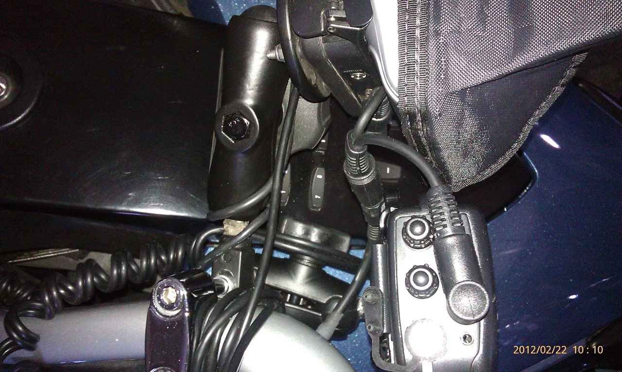

Installed an audio "Y" cable, which connects into the AUX 3.5mm male plug end for the bikes speakers. The "Y" cable splits the CB sound on the left speakers and the GPS on the right speakers.
Purchased the Midland CB from here...http://www.amazon.com/Midland-75-822-Channel-CB-Way-Radio/dp/B00000K2YR/ref=sr_1_1?s=electronics&ie=UTF8&qid=1325882071&sr=1-1

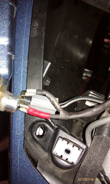

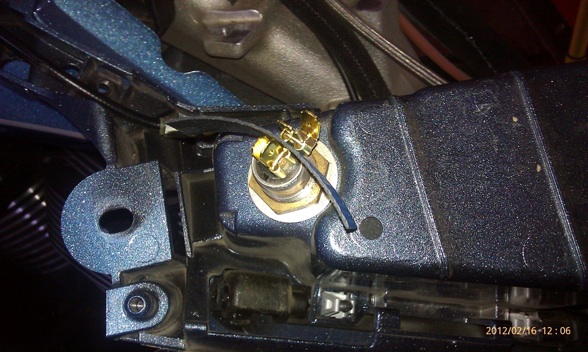

Piggy backed into the Powerlet.

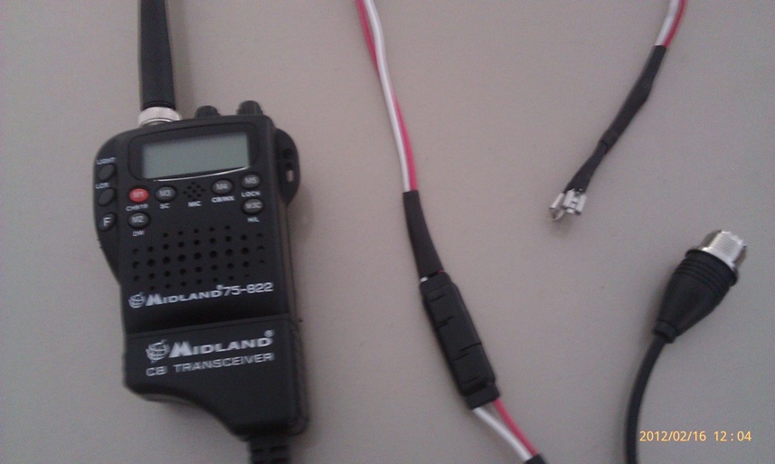

The Midland CB comes with a cigarette plug (not shown here) for power, I cut it off and soldered on SAE plugs (shown). I didn't like all the bulk using the cigarette plug/socket. I did solder a SAE plug to the cigarette plug that I cut off for CB use in the car (not shown).
Purchased the ram-mount belt clip here... http://www.gpscity.com/ram-mount-universal-belt-clip-bar-holder.html
