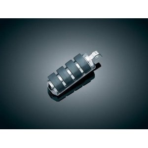

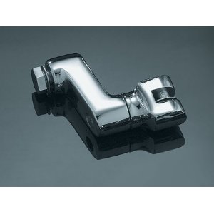

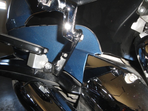

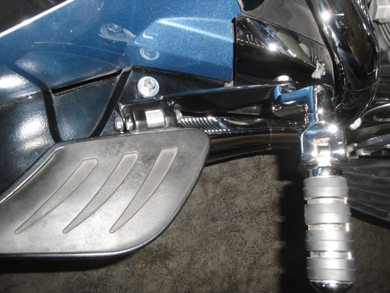

I have installed the jb.hatch passenger peg mount brackets, attached the Kuryakyn Offset Peg Mounts and attached the Kuryakyn 8002 ISO Large Male Mount Pegs. There are other peg mount options.
With my set-up, when standing up, I have a minor inconvenience of the passenger peg touching the backside of my leg behind my knee. I'm still able to balance the bike fine with my wife getting on or off. On the plus side, I noticed if you are late to pick your leg up from a stop and then proceed to make a slow turn,the backside of your leg will touch the passenger peg. You will then pick up your leg before your foot has a chance to get caught/sandwiched between the rear tip over and the road. You need to drill a hole into your rear tip over protectors to secure the jb,hatch passenger peg mount brackets. BTW ... JB.Hatch did quality work on making the pair of black powder-coated passenger peg mount brackets that I purchased.
