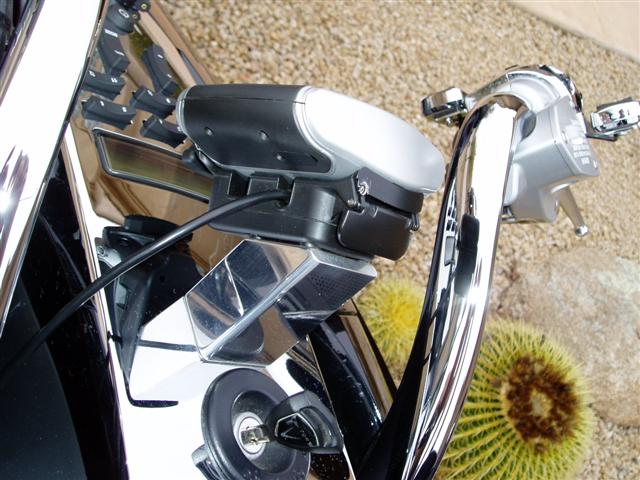

DesertJim
Posted 2008-09-22 6:25 PM (#18582 - in reply to #18534)
Subject: Re: zumo mounting? anyone have luck?
Posts: 496
Scottsdale AZ
http://www.vision-riders.com/bb/photos/get-photo.asp?photoid=581
AZ Victory mount on my Vision
